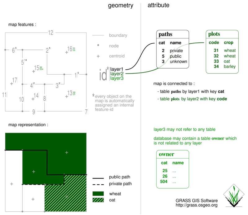

[[File:Catsnlayers.png|800px|thumb|alt=cats and layers in GRASS GIS|center|Figure 1 from [[Vector Database Management]]]]
