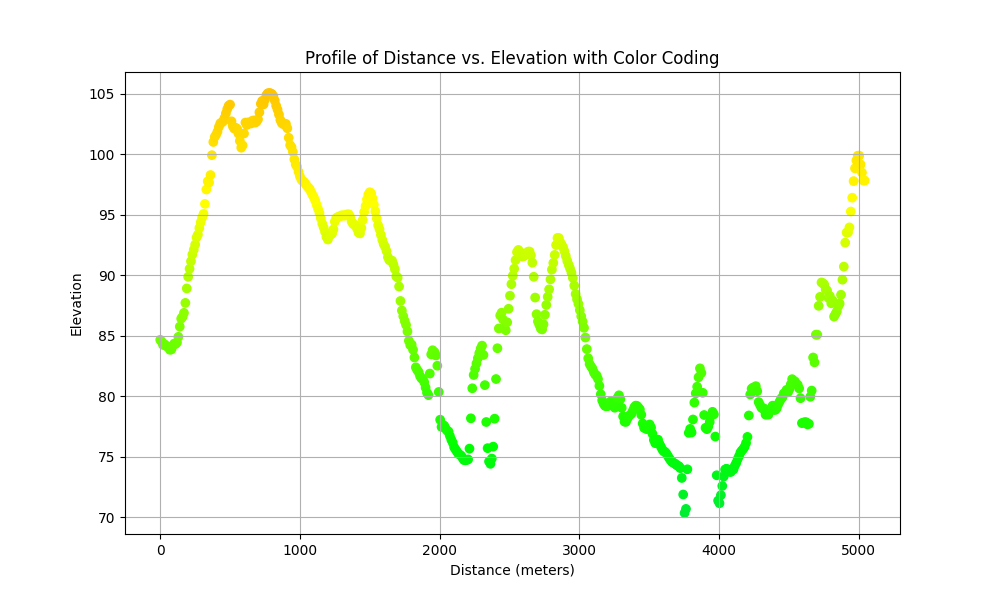

  • r.profile: Updated the JSON output schema. (See PR #5962)

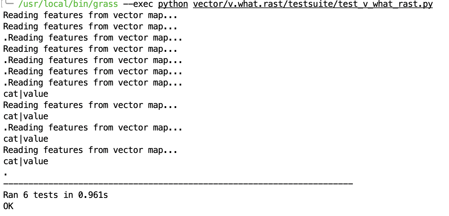

  • v.what.rast (regression tests): Added regression tests to ensure backward compatibility with new JSON support and fixed a sorting bug.

Using r.profile JSON output in Python
The following example demonstrates how the JSON output of r.profile can be directly loaded into a pandas DataFrame and used for plotting with matplotlib.
import grass.script as gs
import pandas as pd
import matplotlib.pyplot as plt
# Run r.profile command
elevation = gs.read_command(
    "r.profile",
    input="elevation",
    coordinates="641712,226095,641546,224138,641546,222048,641049,221186",
    format="json",
    flags="gc",
# Load the JSON data into a dataframe
df = pd.read_json(elevation)
print(df)
# Create the scatter plot
plt.figure(figsize=(10, 6))
plt.scatter(df["distance"], df["value"], c=df["color"], marker="o")
plt.title("Profile of Distance vs. Elevation with Color Coding")
plt.xlabel("Distance (meters)")
plt.ylabel("Elevation")
plt.grid(True)
plt.show()
Sample DataFrame Output (first 10 rows)
         easting       northing   distance      value    color
0  641712.000000  226095.000000   0.000000  84.661507  #71FF00
1  641711.154826  226085.036106   9.999675  84.511765  #6FFF00
2  641710.309651  226075.072213  19.999349  84.241806  #6BFF00
3  641709.464477  226065.108319  29.999024  84.304214  #6CFF00
4  641708.619302  226055.144426  39.998699  84.174400  #6AFF00
5  641707.774128  226045.180532  49.998374  84.112534  #6AFF00
6  641706.928954  226035.216639  59.998048  84.011208  #68FF00
7  641706.083779  226025.252745  69.997723  83.834084  #66FF00
8  641705.238605  226015.288851  79.997398  83.870193  #67FF00
9  641704.393430  226005.324958  89.997073  84.194908  #6BFF00
Visualization
Matplotlib scatter plot generated from the r.profile JSON output:

Test Suite Update
Added 6 tests to the test suite, including both regression tests and future-proof tests to ensure functionality remains reliable in future updates.

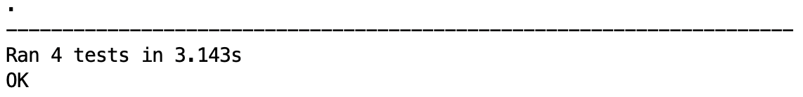

Test Suite Update
Added 4 tests to the test suite, including both regression tests and future-proof tests to ensure functionality remains reliable in future updates.
